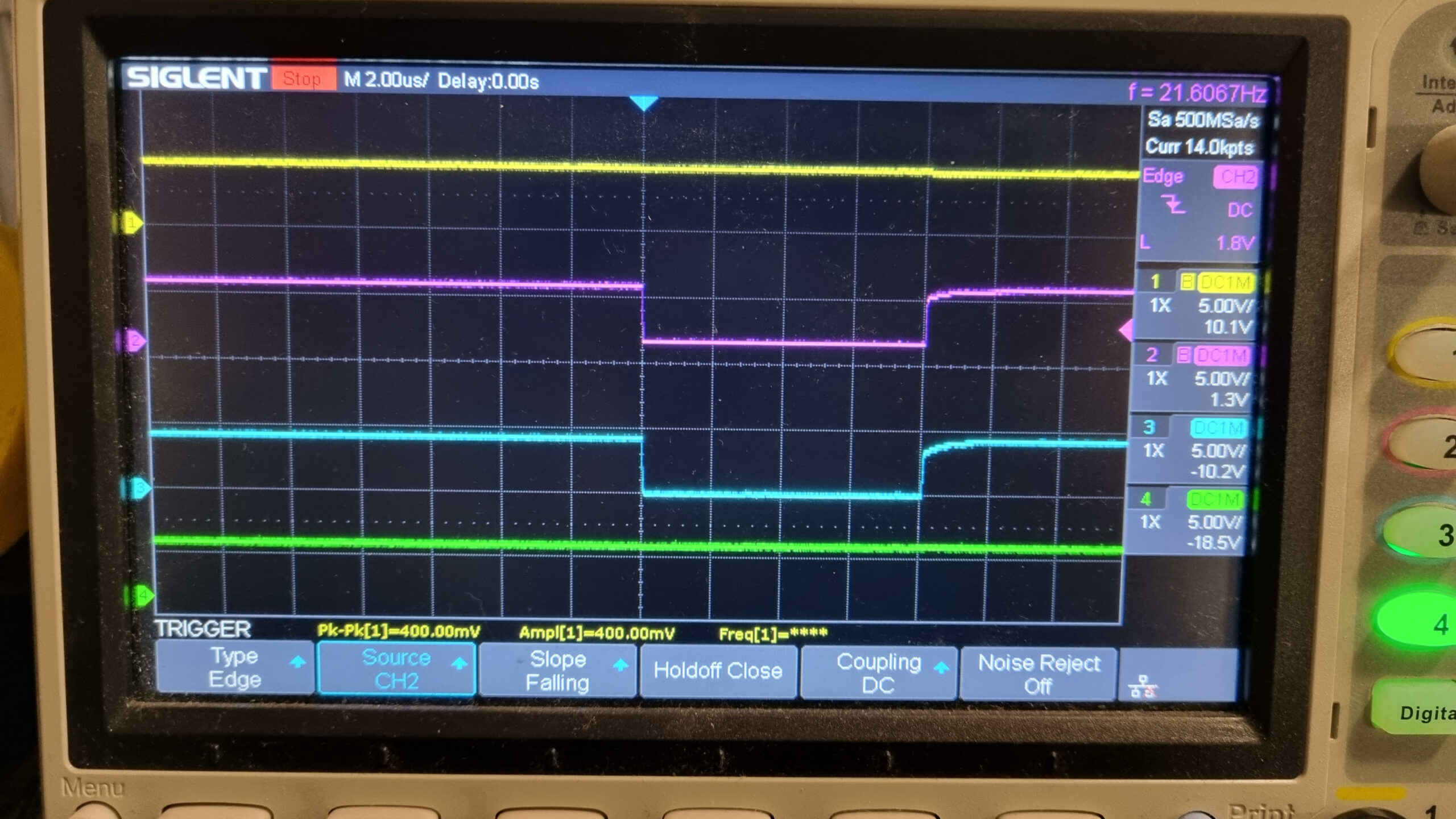

All the following traces are in complemented logic (0 is logic true).
Yellow trace: coincidence output
Purple: Geiger mode OR output
Green: Geiger-1 pulse
Blue: Geiger-2 pulse
These two pictures are pulses from the two tubes:
(https://www.madexp.it/wp-content/uploads/2024/11/geiger-1-scaled.jpg)
(https://www.madexp.it/wp-content/uploads/2024/11/geiger-2-scaled.jpg)
This one is the output with pulse coincidence:
(https://www.madexp.it/wp-content/uploads/2024/11/coincidence-scaled.jpg)
